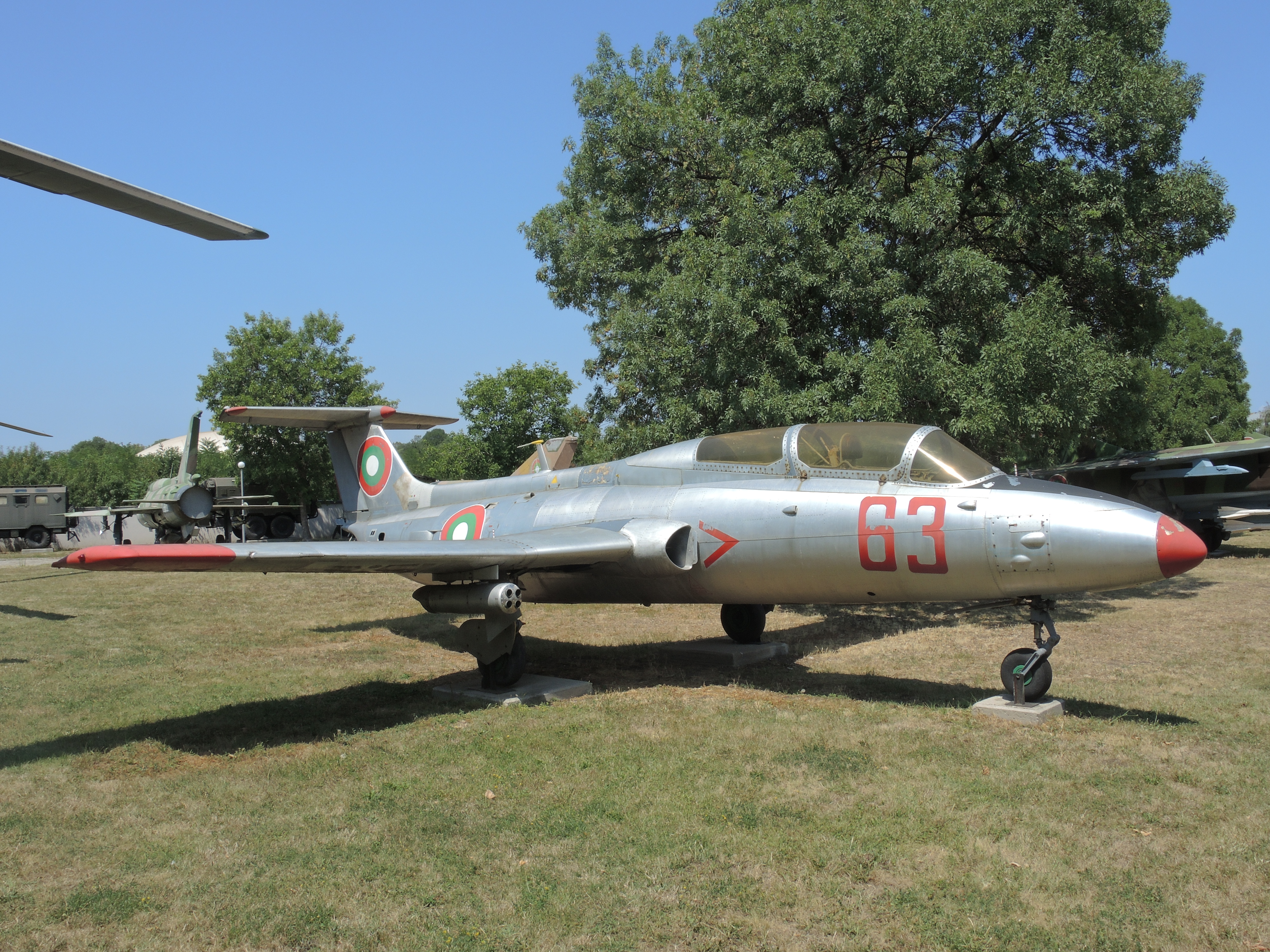

Sofia, Museum of Military History, August 7th, 2025
Вложение 123741
L-29 Delfin 63 with factory number 892941
